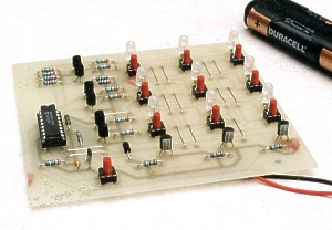

A PICmicro dice machine
Image courtesy Everyday Practical Electronics.
